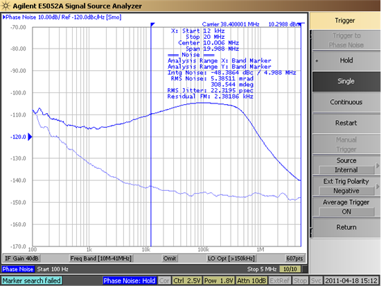

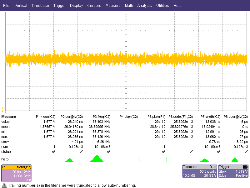

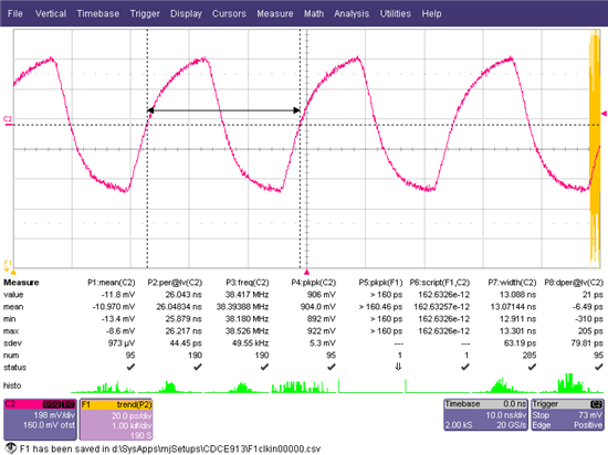

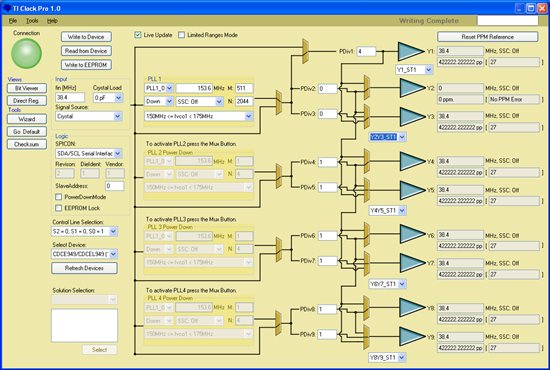

    It is possible to use the CDCE9xx series as a clock generator (with PLL on) by connecting a TCXO in the way described in the application notes you are referring to. The Rf internal in the CDCE9xx series is approx 500kOhms, therefore it is not needed to connect one externally.
    It would be recommended connecting 1nF in series with XIN and programming the CDCE9xx clock input as XTAL with the minimum internal capacitance load selected. Please note that when the PLL is active the rms jitter for an integration bandwidth of 10kHz to 20MHz would be around 22ps rms. The peak to peak jitter can be as low as 30ps peak to peak for 10k cycles.
    For the setup described above please find below the phase noise in Y3.
