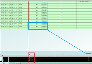

My customer want to set the EEPROM to LMK05318 on their own FPGA. They record the registers which is the sequecncy of program EEPROM on TICS Pro.
When they set done the config and capture the record of registers as below:
But somehow it goes wrong, outputs are not responding after using the record registers on their own board.
They found that I2C register address had been change to 50h from 64h.

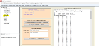

    2. To program the EEPROM using TICS Pro:
    First, navigate to the EEPROM page on TICS Pro as shown below.

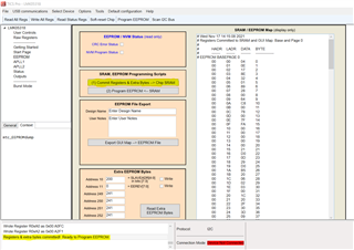

    Second, commit the registers and extra bytes to the SRAM by pressing the button highlighted in the image below.

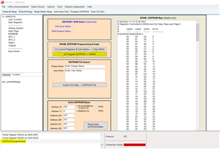

    Third, program the EEPROM from the SRAM by pressing the button highlighted in the image below.
