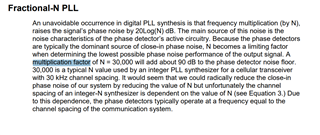

They guess that equations as below can be used for the calculation, but not sure. And they also want understand the equation can be used for both Fractional-N PLL and Integer-N PLL. Could you also confirm this?
They also have a question about the app note as below.  On P.6 in the app note, we can see multiplication factor. Could you tell the definition of it?
https://www.ti.com/lit/an/swra029/swra029.pdf?ts=1637327553034&ref_url=https%253A%252F%252Fwww.google.com%252F
