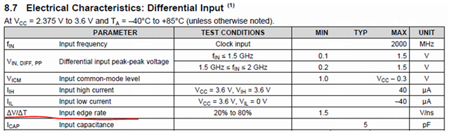

Part Number: CDCLVP1204
Hi Team,
Customer is consulting how to measure below input edge input? Should they measure the single-end input signal or differential input signal? Thanks

Hello Stanley,
This should be measured on the differential signal. So one way to do this is put inverting and non-inverting output into scope then do math on those traces to get the Vdiff p-p plot. Then to the rise/fall on that math trace.
