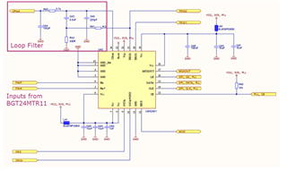

    For reference, the circuit is as follows.
  • Hi Kiman,
    Can you measure the waveform at CPout pin?
    Another test, simply lock the VCO to 1514.0625 without ramping, does it lock? What is the CPout voltage?

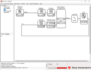

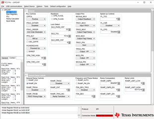

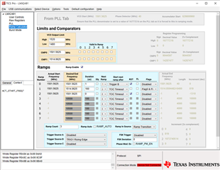

  • Hi Kiman,
    Please try the attached .tcs file.
    After the LMX2491 is powered up and both the reference clock and VCO signal are ready, press Ctrl and L keys to load all the registers to the device. It will lock to 1501.5625MHz and the MUXOUT pin will turn HIGH. Please measure the CPout voltage.
    Then change the VCO frequency to 1514.0625MHz and then press Enter. Again measure the CPout voltage.
    If the CPout voltages are between 0.5V and 2.8V, and MUXOUT pin is HIGH, we should be able to ramp between these frequencies.
  • .tcs file is here.2491e2e.tcs

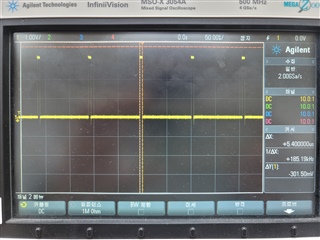

  • Thank you for answer.

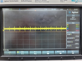

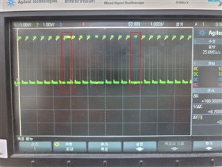

    I see the Raw Registers value in the TICS PRO program and do spi communication directly from the firmware.
    This is an oscilloscope picture of cpout after spi communication setup.
    As before, a small signal comes out every 16.6us.
    The maximum voltage is between 80 and 100 mv.

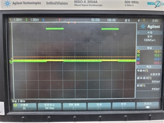

  • This is the result of debugging TRIG1 by applying the uploaded tcs file.
    TRIG1 => 5.3us
    It was confirmed that the waveform was generated like this.
  • Hi Kiman,
    If the first plot was taken without ramping at VCO = 1501.5625, then I think the PLL is not locking at all. What was the MUXout pin voltage? I guess it should be LOW.
    let's do some debug.
    Set the MUXout pin to R/4 or N/4. If you see a 10MHz clock with R/4, that means the PLL input path is good, the 40MHz reference clock is ready. If the PLL is locked, you should also see a 10MHz clock with N/4. Since the PLL is not locking right now, you should still see something close. The purpose of these tests is to verify both the input path and feedback path have no issue, the unlock is due to something else.

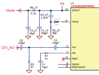

    OK, there must be something wrong with the VCO signal input. How did you connect the Q1 and Q1N pins of the transceiver to the LMX2491?
  • Thanks for the reply.

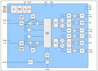

    LMX2491 is connected with BGT24LTR22 chip.
    In the case of BGT24LTR22 chip, it is not divided into Q1/Q1N and receives FeedBack with one PIN.
    It is connected to DIV_AO pin of BGT24LTR22 and Fin pin of LMX2491.
    And the same result was obtained even if there was no connection between the DIV_AO pin and the FIN pin.
    I'm not very good at circuit configuration yet, so if there is a problem with the circuit, please let me know.
  • Hi Kiman,
    Fin* pins should not be tied to ground directly.
    Please try below, Fin and Fin* can be swapped, it does not matter which one is the VCO input. The loop filter value is based on a loop bandwidth of 500kHz.
    As shown in the figure below, both the circuit that receives the DIV_AO signal from FIN or the circuit that receives the DIV_AO signal from FIN* can have the same result.
    Either circuit can be used.

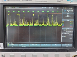

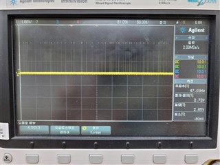

    The CPOUT signal occurs at random intervals as shown in the figure below.
    And the other picture is an enlarged one of the waveforms.

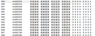

    If you look at the register settings you sent, all register values between R92 and R86 are set to 0X00. Is this the right setting?
  • Hi Kiman,
    The contents of registers R86 to R92 are empty because I am not going to ramp.
    What was the VCO frequency in your plots?
    The PLL is not locking at all. We really need a spectrum analyzer to spot the DIV_AO signal, otherwise it would be difficult to debug.

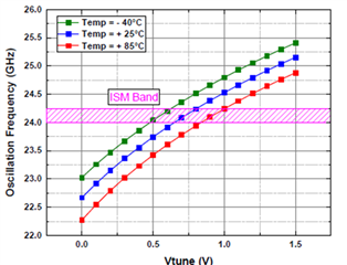

    The FIN connection part is a signal sent from RF, so I checked the RF data sheet again.
    First of all, the power of RF uses 1.5V.
    And if you look at the graph below, the ISM band is between 0.6 and 0.7.
    Even if only ISM BAND frequency is used, is it correct to set the CPM_THR_LOW and CPM_THR_HIGH values as follows?
    CPM_THR_LOW => 0.5V
    CPM_THR_HIGH => 1.5V

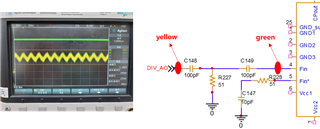

    And I checked the position of the DIV input part differently.
    The YELLOW part is a signal coming from RF and the waveform is out.
    PEAK-PEAK => 98mV
    Max => 147mV
    GREEN is a signal input to the FIN of the PLL.
    Max => 1.5V
    I wonder if it is correct to change the waveform like this.
