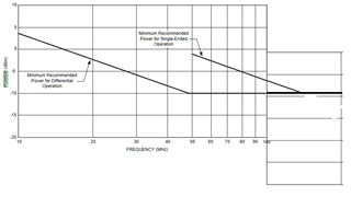

hi,
please let me ask for the power of "OSCin INPUT". How much the power of "Recommended OSCin" when this device is used with single-ended sine wave input and at 200MHz?
The catalog shows it up to @100MHz, but it doesn't tell me the power at more than 100MHz...
Tatsuro
  • Hello Tatsuro-san,
    Since the minimum required input power is a linear trend defined by minimum necessary slew rate until -10dBm, I tried copying a section of the graph representing the log step from 10^n to 2*10^n, and extending the lines from the single-ended and differential sections:
    -10dBm is also the minimum recommended power for single-ended operation at 200MHz. You can of course operate higher than -10dBm as well, likely up to +10dBm before the input amplifier circuit within OSCin starts to saturate and performance degrades.
