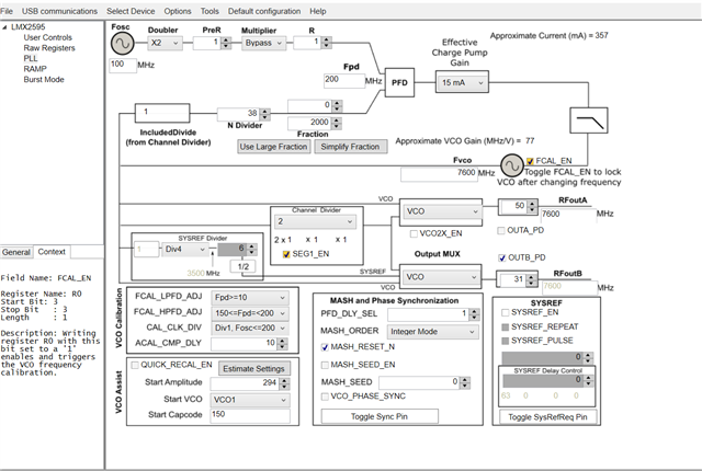

Hello, I have another question. Now I use full assist mode and jump the frequency from 7.6GHz to 7.8GHz. My question is, the frequency jumping failed and below is the output. The power is even below 0dbm.
Here's my progress.
1. Program RESET = 1 and then program RESET = 0;
2. Program registers as shown in the register map in REVERSE order from highest to lowest.
3. Wait 10ms
4. Program VCO DACISET and VCO CAPCTRL to the values that the first frequency acquired , and program VCO_SEL_FORCE, VCO_DACISET_FORCE, VCO_CAPCTRL_FORCE to 1
5. Program FCAL_EN = 1.
6.
1) Disable CPG.(set CPG to 0)
2) Program N divider from 38 to 39.
3) Program VCO_SEL, VCO DACISET, VCO CAPCTRL that the second frequency acquired.
4) Enable CPG.(set CPG 15mA again)
7. Program FCAL_EN = 1.
Is there any thing wrong with my flow in full assist mode? Or are there any docs about changing frequency in full assist mode that I can refer to? Thank you!

  • Thank you for your answer and information, I will try and come back soon. After reading the app note you provided, I still have some questions.
    1) Under such circumstance, in lock detect mode(R0[2]=1), the muxout pin is high. So the VCO is indeed locked, but locked in the wrong frequency, am I right?
    2) About the figure below, in the first box, what does the 'automatic calibration' mean? Does it mean that I should program the VCO_SEL,VCO_CAPCTRL_STRL,VCO_DACISET_STRL in no assist or partial assist mode to see if it can be locked? And read back the R110,R111,R112 to see if those three readback values are exactly the same as I wrote?
    3) I just use the bottom two steps, and not enable FCAL_EN the whole case. rb_VCO_DACISET,rb_VCO_SEL are the same as what I programmed, but rb_VCO_CAPCTRL is not and rb_LD_VTUNE is not 2. When I program FCAL_EN to 1, the situation has not changed.  Sometimes rb_VCO_CAPCTRL is even 0. Is that normal?Those three values are carefully calculated by the equation in the doc.
    I need to use the full assist mode in order to jump to another frequency as quickly as possible. Could you give me more advice? Thanks a lot!

  • Thank you for your answer! I am sorry I can't get your point. My question is what the auto calibration is.
    I noticed that the first three steps are before the three force bits(R20,R8), so those steps mean to get the values that are used in the last box, and which is also the readback values in R110,R111,R112, am I right?
    The values of VCO_CAPCTRL and VCO_DACISET are carefully calculated using the equation below. So can I just skip the first three and use the ones I calculate from the equation below?
    BTW, I just noticed that those equations are for the *STRT. So can the values be used in full assist mode?
    The main point of full assist is that it forces the values that have been calibrated by LMX2595 of the related frequency in order to reduce the calibration time. Is that correct?

  • So what should I use in full assist mode? In other words, what is the VCO_CAPCTRL, VCO_DACISET?
  • Hi Liu,
    capctrl, daciset and vco_sel values are obtained by calibration. Then do a register readback and put these values in a look up table for all the desired frequencies. Next time when you want to lock it to one of the desired frequency channels, grab the data from the look up table and apply them in full assist mode.
  • So I give the values calculated from the equation as the start value, and use the readback values in VCO_SEL,VCO_CAPCTRL, VCO_DACISET field, right? I think you have missed my questions, please tell me if my understanding is correct. Thank you!
  • Hi Liu,
    I though I have explained before. If you use the calculated VCO values, that is partial assist. Full assist does not require calculation but a pre-calibration for all the desired frequencies is needed so that you know what VCO values should be used. When you apply the VCO values in full assist mode, no calibration is needed anymore. As a result, frequency switching time is reduced.
