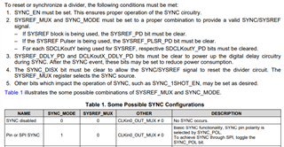

I have a problem with the SYNC operation which not always operate. Sometimes the sync operation works and I can see that the delays I entered take effect, but sometimes it looks as if nothing changed and that sync did not occur.
The SYNC I am using is internal in Continuous mode.
The values of the relating registers are.
REG 139 Value  03h
REG 140 Value  81h
REG 143 Value  10h
REG 144 Value FFh-------------- START SYNC ASSERTION
REG 144 Value 00h
REG 144 Value FFh-------------- STOPSYNC ASSERTION
Any thoughts?

    I would be assuming you are following the section 9.3.1 of LMK04828 datasheet for asserting the SYNC.
    For your setup examine, would be great, if you can share the used configuration or full register settings.

  • Hi Yoel,
    I usually prefer to have TICS pro format config file to recheck on GUI. But anyways, I could manage with the available format data.
    While you are performing the SYNC, SYSREF_MUX set to 0 (Normal SYNC) and toggle the SYNC_POL along with 0x144 --> 00 to allow the sync signal to reset the divider circuit.
    So in your configuration, SYNC should be asserted (SYNC_POL toggle) as shown below:
    REG 139 Value  03h
    REG 140 Value  81h
    REG 143 Value  10h
    REG 144 Value 00h   <--------   SYNC_POL toggle (SYNC insert)
    Thanks!
    Ajeet Pal
  • Thank you Ajeet!
    This certainly clarifies some issues.
    After sync is done, do I need to return SYSREF_MUX to  3 (CONTINUES MODE)?
  • Hi Yoel,
    Yes, After sync operation, you can adjust the SYSREF_MUX to continuous or pulsar mode based on use case.
    Ajeet Pal
