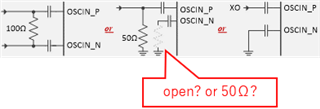

Please tell me the internal circuit (internal connection) of OSCIN_P(Pin.8) and OSCIN_N(Pin.9).
The input is high impedance and requires AC-coupling caps at the pin. A CMOS clock or XO can drive the single-ended OSCIN pins. Differential clock input is also supported.
Example input terminations:

Thank you for answering.
Is the OSCIN_N pin in the middle of Example input terminations correct to open? Or is it 50Ω?

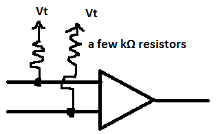

What is the internal circuit from the OSCIN_P pin and OSCIN_N pin to differential single conversion?
Hi Shimizu-san,
With single-ended input, you could connect the input clock to one of the pins, either _P or _N pin. The unused pin should be AC-coupled to the ground directly or via a 50Ω resistor.
What specific information you are looking for from the internal OSCin circuit?
Hi Shimizu-san,
The input pins are biased to a certain voltage with a few kΩ resistors, that's why AC-couple is needed.
