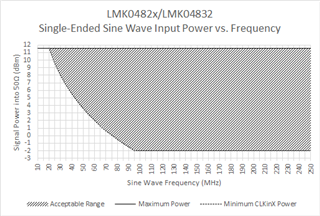

    The clock amplitudes seem okay, as long as it gets above 2V and below 0.4V it should trigger. The external 25MHz clock amplitude should probably be higher if it is a sinewave, at least +10dBm, to satisfy the minimum slew rate requirement as well (0.15V/ns implies about 9.7dBm required amplitude at 25MHz to achieve the necessary slew rate) - see the graph below.
