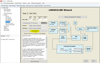

If I increase the configured and supplied freq of PRIREF in steps, i.e.  25MHz then 50MHz then 80MHz then 90MHz then 100MHz I can get it to recognize 100MHz PRIREF.
However if I configure an supply 25MHz, then reconfigure and supply 99MHz or 100MHz. it indicates not valid. Tried soft chip reset then write all registers does not help.

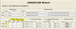

Disabling Late/Missing Detector disabled is needed for it to declare valid.
According to datasheet (9.3.7.2.4), missing pulse detection should work up to (fVCO1)/12 = 2400MHz/12 = 208MHz.
