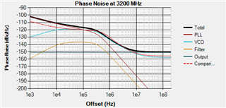

    But in cases where LMK04832 could be used, it usually comes out ahead. Comparing an LMX2572 at 3.2GHz to an LMK04832 at 3.2GHz (using the latest PLLatinum Sim, version 1.6.0.0 as of this post):
    • LMK04832, 3.2GHz carrier, 320MHz phase detector, integration range 1kHz to 20MHz, I get about 56fs jitter.
    • LMX2572, 3.2GHz carrier, 200MHz phase detector, integration range 1kHz to 20MHz, I get about 71fs jitter.
    • Plot below shows black line (LMX2572) optimized, vs dotted red line (LMK04832) optimized:

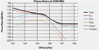

    This comparison favors LMK04832 since the phase detector frequency can be higher and the in-band PLL noise can be reduced, but the floor is inarguably better since LMK04832 can use CML bypass mode direct from the VCO whereas LMX2572 is using the lower-performing divider path. If we pick a different example at 2.5GHz:
    • LMK04832, 2.5GHz carrier, 250MHz phase detector, integration range 1kHz to 20MHz, I get about 54fs jitter.
    • LMX2572, 2.5GHz carrier, 250MHz phase detector, integration range 1kHz to 20MHz, I get about 70fs jitter.
    Still favorable for LMK04832, because the noise floor is better and the N-divider can be lower.

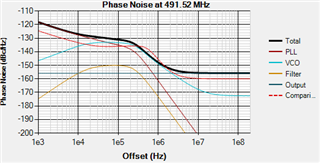

    Now, if I pick both devices to do 491.52MHz, with a 122.88MHz input source:
    • LMK04832, 491.52MHz carrier, 245.76MHz phase detector, integration range 1kHz to 20MHz, I get about 68fs jitter.
    • LMX2572, 491.52MHz carrier, 122.88MHz phase detector (limited by divider requirements), integration range 1kHz to 20MHz, I get about 88fs jitter.
    The divider floor on the LMX2572 just isn't very good relative to the LMK04832, and the higher supported integer mode phase detector clearly improves performance a lot. LMK04832 still performs better in-band due to the lower N-divider.

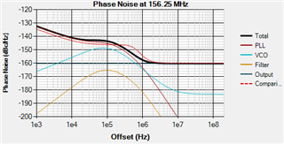

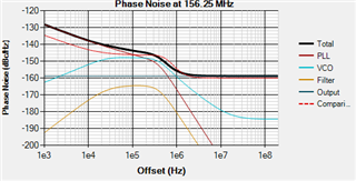

    Finally, picking 156.25MHz output, with 125MHz input source:
    • LMK04832, 156.25MHz carrier, 250MHz phase detector, integration range 1kHz to 20MHz, I get about 91fs jitter.
    • LMX2572, 156.25MHz carrier, 250MHz phase detector, integration range 1kHz to 20MHz, I get about 104fs jitter.
    Now even with the floor advantage mostly gone, LMX2572 still has significantly worse PLL noise because of the higher N-divider. Maybe over a wider integration bandwidth the floor contribution could add up.
