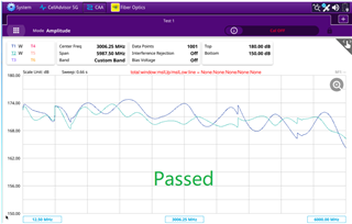

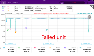

We found LMX2572RHAT have some problem, need FA, pls support
We order 1000pcs LMX2572RHAT  from your TI STORE by PO#ME81M0345262, but now we found
Found the 13.5% (54pcs out of 400pcs)failure rate for this one material due to it failed at Function test with Noise failure , we did swap experiment to verify it still failed, here we will send 3pcs for you for FA,pls comment

1. Pls. provide IC level failure description. How to confirm noise is caused by IC?
a. Which function cannot meet TI datasheet or which pins have the abnormal behavior
b. Customer testing limits/condition.
c. Customer measured value (failed vs. good), if waveform is appreciated.
