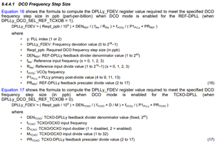

  • Yes.
    1. How to calculate step size from ppb?
    2. Is these below two registers used for adjusting the clock?
    DPLLy_FDEV, DPLLy_FDEV_REG_UPDATE
    3. Is there any GPIO registers to enable before clock adjustment.
    4. Please share us a psudo code for clock adjustment.
    Anji
  • Hello Anji,
    1. Section 9.4.4.1 in the data sheet shows the equation for calculating the step size from ppb.
    2. Yes for adjusting the clock, the DPLLy_FDEV sets the step size and the DPLLy_FDEV_REG_UPDATE increments or decrements that step size from the numerator. Also please note that the DPLLy_FDEV_EN must be high for the DCO mode to be enabled and the DPLLy_DCO_SEL_REF_TCXOB must be set to select between TCXO DCO mode and REF DCO mode.
    3. The DCO mode can be operated using GPIO pins, but I would recommend using the register method. The register method only requires the setting of the 4 controls described in number 2 above.
    4. The TICS Pro GUI has a user friendly interface that can be used to better understand how the DCO functions.
    Basically to perform a frequency adjustment, the sequence is as follows:
    1. Enable DPLLy's DCO feature by setting the DPLLy_FDEV_EN high.
    2. Select whether the DCO adjustment needs to be TCXO mode or REF mode by setting DPLLy_DCO_SEL_REF_TCXOB.
    3. Write the step size required to the DPLLy_FDEV registers.
    4. Set the DPLLy_FDEV_REG_UPDATE low for an increment and high for a decrement.

    Based on above procedure, I implemented C function. Tried to test, its not working. Could you please check below code snippet. Let me know if i am missing anything.
    int lmk_clock_control(int64_t ppb) /*ppb value will come from ptp4l */
    int64_t step_val = 0;
    uint64_t DENref = 1099511627776;
    uint64_t fIN = 390625000;
    uint64_t fVCO = 5156250000;
    int Rin = 1, P1_PLL = 4, PR_ref = 4;
    uint8_t data1,data2,data3,data4,data5;
    /*calculate step size */
    step_val = (ppb/1000000000) * DENref / (fIN/Rin) * fVCO / (P1_PLL*PR_ref);

  • Hello Anji,
    You need to write the FDEV registers in the opposite order. The FDEV will take effect when the LSB is written. So for DPLL1, FDEV should be written to 0x0246 first and to 0x024A last. Same sequence applies to DPLL2.

  • Hello Anji,
    1. The target ppb is the ppb adjustment you want to make to your output clock signal. For example, writing a 10 ppb target and then pressing the increment button will result in a 10 ppb addition to the APLL numerator and therefore the output clock will be increased 10 ppb as well.
    2. When the ptp4l returns a ppb offset, you will be that many ppb off of your target frequency. Therefore using that ppb offset, calculate the DPLLy_FDEV and then either preform a increment or decrement based off of the direction in ppb offset you are. Please ensure you are making the adjustment in the correct direction.
    3. To make a negative adjustment you must press the decrement button. The ppb value will always be entered as a positive number and then the increment and decrement buttons determine whether the ppb will be subtracted or added to the APLL numerator to preform the adjustment.
    Also please remember that the DPLLy_FDEV_REG_UPDATE control determines whether an increment or decrement will be occurring.
