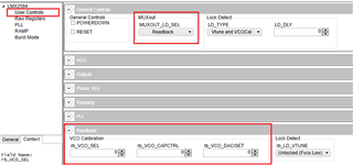

    Could you also do a register readback for the following registers?
    R110, R111 and R112.
    Compare them with a good device, I want to see if the unlock is due to calibration.

    Here is the register readback and the Vtune voltage
    Register Name
    GOOD (addr/value)
    BAD (addr/value)
    R112
    0x700153
    0x70015c
    R111
    0x6F0039
    0x6F003A
    R110
    0x6E0488
    0x6E0188
    Vtune
    1.24v
    0v
    Mike
  • Hi Michael,
    The calibration is fine, both devices return similar calibration data.
    Vtune is zero voltage, maybe there is some connection problem with the loop filter, would you take a look on the loop filter?
