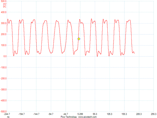

My USB Oscilloscope has a fault on it - so cannot guarantee the outputs - which are set to CMOS.
Is the connection of the REF_IN- pin to the oscillator an issue as the waveform output by the oscillator (24.576MHz) is not looking optimal - positive plateau seems to be ok, but negative is nearly a saw tooth. I have about 3mm of ground plane along one side of the track and obviously tracks either side after this as IC dimensions dictate this for 2mm to 3 mm.

    As an update - i checked the oscillator output capability - the maximum capacitance that can be seen is 15pF. The x1 probe setting has a capacitance of 46pF + Oscilloscope - hence in excess of the output capability of the oscillator.
    The x10 setting has a capacitance of 11pF and the waveform looks much better - not perfect, but the input capacitance of the CDCE62002 being 3pF means that the load is near a maximum. Hence removing the probe 11pF will resolve the waveform issue.

    4. The Clock Oscillator input is acceptable - the GIF image is for a x10 probe - which causes the load capacitance to be exceeded for the Oscillator output :
    Hence once the probe has been removed the waveform should improve.
