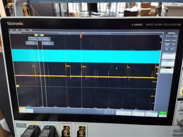

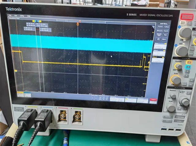

  • Hi Derek,
    Thank you for your prompt reply!
    We have tried for several times according to your suggestions. But it seems to still have no effect. In all of the cases, generally, there are two situations:
    A. Only Change every 0x143/0x140/0x138 as your suggestion( and also, I have deleted Step 5-a).
    B. Besides option A, we also change 0x103/0x123/0x12B/0x133 to 0x44. (For this situation, the configuration file is attached at last)
    In case A, the frequency of DCLK & SCLK output is steady, but the phase between them is still changing dynamically.
    In case B, the frequency of SCLK output is changing dynamically, which is much lower than 15.625MHz, while the frequency of DCLK output is steady 1GHz(the realtime waveform, which is recorded as mp4 video, is also attached at last. In the video, the blue waveform is DCLK-1GHz, the yellow waveform is SCLK-SYSREF, which has the dynamically changing frequency all the time.).
    According as Figure7&8 in the Datasheet, however the DCC module can only have an affect on the DCLK outputs, turning on the dcc module seems to have a powerful influence on SCLK outputs in case B. So how can we achieve the fixed deterministic phases of DCLK to SCLK in the triggerable continuous SYSREF mode?When DCC is required? Why enabling DCC can cause SCLK-SYSREF output unsteady?

  • Kaibo,
    This is very strange - there should be no effect from enabling the DCC module on the SYSREF outputs. Moreover, the SYSREF should be phase-stable to both of your clocks.
    I tested your configuration and programming sequence on an evaluation board in our lab, and I did not see any of this strangeness - when I apply 3.3V to the SYNC pin, I see a stable, phase-aligned SYSREF.
    I see in your programming sequence you preface the SPI data with lots of leading zeros. Are you toggling the chip select in such a way that only 24 bits are programmed? I assume this must be the case since you're getting 1GHz output, and programming wouldn't work if you were trying to program 32 bit transactions or something. You might also confirm with readback (if possible) that you are programming what you think you are programming, but again I suspect this isn't the issue and your board may not be set up for readback. It's probably simpler and quicker to check communication by just toggling the powerdown bit and observing the device powering down.
    After completing your programming sequence, try programming 0x013903 to set the output to continuous SYSREF. Does this work as expected? If yes, revert to 0x013912 and apply the SYNC trigger to generate your continuous SYSREF, then probe the voltage at the SYNC pin voltage (pin 6) and ensure that it is above the minimum VIH of 1.2V and below the VIL of 0.4V for high/low signals respectively. In theory even this shouldn't be an issue - the SYSREF_REQ function should be synchronous to the SYSREF divider, so glitch pulses should never happen.
    If even continuous SYSREF is not working as expected, this suggests there is something wrong with either your device or your board. The schematic in your post looks similar to the EVM, and I assume the layout is as well - but it might be prudent to check that you have sufficient supply current available (LDO should be up to 1.5A for this device, though steady state device current should be closer to 1A with your configuration) and that the supply voltage at the clock output power supply pins or the SYSREF power supply are receiving sufficient voltage. If you have another board, check if the issue is replicable on multiple boards.
