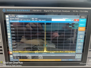

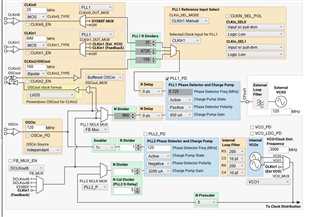

I have an issue in the mentioned PLL and it goes line this, Simulation has been done for the conversion of 120MHz to 150MHz in TICS Pro simulator and export all the register values from the simulator. After that I load the file in my module which is having the LMK04828B PLL and I got the output of 150MHz with the shift of 1.2MHz. Refer the attached image of clkin and PLL selection, Clock outputs, and output frequency of 151.2MHz. Refer the register file also.
What might be the reason for that delay/shifting in the output frequency or shall I do any change in the simulator file?
Please check and provide me the best solution.

  • Hello Kingslin,
    I see two immediate issues:
    1. Maximum Fpd of PLL2 for LMK04828 is 155MHz. You should disengage the doubler. (There is no warning from TICS Pro about this misconfiguration, so I apologize for this error - I've fixed it and it will be clearer in subsequent TICS Pro releases)
    2. 2400MHz is not a supported VCO frequency on LMK04828. 3000MHz is, with VCO1; you could set the N Prescaler to 5, the N divider to 5, and the N Cal Divider to 5. The channel divider would be set to 20 to produce 150MHz.
    On the current version of TICS Pro, 2400MHz VCO should have colored the VCO box red and indicated this is an impossible frequency target. I'm not sure which version of TICS Pro you're using, but I suggest downloading the latest version from TI.com.

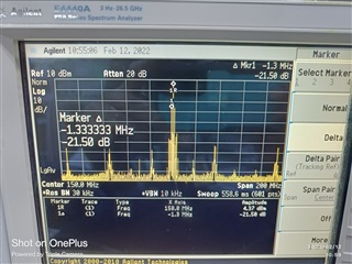

  • Hi Derek Payne,
    Thanks for the information. As stated above, the mentioned frequency and divider settings has been kept. PLL is generating the power level of 150MHz but the spurious level is near to the fundamental frequency(150MHz).
    Refer the attached image of settings and the output of the PLL. What might be the issue for that spurious level?
    Please provide the best solution to avoid the spurious level.
    Note : The reference frequency is 120Mhz which is generated from OCXO Module and also from signal generator. In both cases the spurious level is not suppressed.

  • Kingslin,
    Your spur levels are very high, and this is unusual. This is an integer PLL, there shouldn't really be any spurs at that magnitude or offset. This shouldn't be coming from either the PLL or the VCO. I would expect this to be part of the reference, or part of the power supply.
    • Have you checked the spectrum on your reference? Are you certain there is no spur at the observed offset?
    • Is the on-board 122.88MHz VCXO for the EVM disabled (supply ferrite removed to prevent any spurious coupling between VCXO and OSCin signal)?
    • What power supply are you using? Is it a switching supply, potentially at around 1.3 MHz?
    Derek Payne
