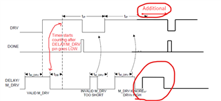

Hi team,
One of my customers is evaluating TPL5111 for their new products.
At this moment, the customer has the following questions.
Could you please give me your advice?
Q1. We’d like to extend the device interval time using DELAY/M_DRV terminal after DRVn rising from L to H.
    Is there any way to extend DRVn H level?
Q2. Can DRVn be kept H level when DELAY/M_DRV terminal is pulled up to VDD?
Sincerely.
