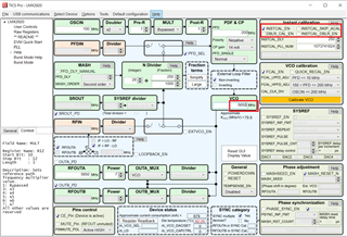

    Regarding to your query, I believe you are following the Instant calibration procedure mentioned below:
    1. Open TICS Pro and select EVM default mode configuration
    2. In User Controls page, check all Double Buffer bits
    3. In PLL page, uncheck DBLR_CAL_EN in Instant calibration box
    4. Vcc power up the EVM
    5. Press Ctrl+L to program the EVM to lock to 6GHz
    6. Set INSTCAL_EN = 1 in Instant calibration box
    7. Type 5650 and then Enter in the VCO box (PLL_NUM, PLL_N and INSTCAL_PLL_NUM will be programmed automatically)
    8. Uncheck FCAL_EN in the VCO calibration box
    9. Check FCAL_EN
    10. Uncheck FCAL_EN and wait for a while (VCO will lock to 5650 MHz)
    11. Change VCO frequency, for example, type 5800 and then Enter in the VCO box (PLL_NUM, PLL_N and INSTCAL_PLL_NUM will be programmed automatically)
    12. Click Calibrate VCO button (this will write R0 once, VCO will lock to 5800 MHz)
    13. Change VCO frequency to 6200 MHz
    14. Click Calibrate VCO button (this will write R0 once, VCO will lock to 6200 MHz)
    Once, LMX2820 is calibrated for Instant cal, how are you measuring the lock time in transient mode of instrument?
    It suppose to be in external trigger mode and capture the frequency settling data with lock detect pin of LMX2820.
    Would be great, if you can share your used configuration file (TICS pro format) for required frequencies and can validate in our setup.
    Thanks!
    Ajeet Pal

    I have done the quick test on EVM with the below configuration file and further steps, LUT would generate and lock the PLL at 5650MHz, just after FCAL_EN -->0. and next frequencies shows the fast lock time. I have saved the plots for you but unfortunately my PC got restart and lost all data. I will share the reference plots by Monday after retest on EVM.
    1. Load below config file
    LMX2820_INSTCAL.tcs
    2. update TICS pro with highlighted section
    3. FCAL --> 0 --> 1--> 0 (LUT generates and lock the PLL at 5650MHz)
    4. Now, change the frequency and click on "Calibrate VCO". See the settling time.
    There can be frequency drift in the RFout based on reference frequency stability and may need to set the target frequency in instrument for exact frequency.
    Please try the above again and see the performance.
    Thanks!
    Ajeet Pal
