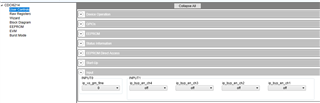

I have a technical support question regarding your CDCI6214 chip. we are using this clock generator to redistribute a single ended 125MHz clock from a phy. We are using the REFP input for the 125MHz signal, as per the datasheet, and have set the registers to get a 125 differential signal on Y1 and Y2 (P and N). The problem is that we aren't getting any clock signal on the outputs. We've used the TICS pro application to make sure that the registers are set so that the signal should be routed correctly. The configuration we use is added below, as I could not find any possibility to add attachments.

  • Hi Peter,
    you have to enable the bits ip_byp_en_ch1 and ip_byp_en_ch2 (or set to 1).
    Field Name: ip_byp_en_ch1
    Register Name: R27
    Start Bit : 11
    Stop Bit : 11
    Length : 1
    Description: Bypass path buffer enable
    Julian

    please try to load this setting (buffer mode with LVDS outputs):

  • Thanks Julien,
    With those values I do get something on the output! Does this mean that the bypass mode is not functioning?
    I have some questions though, I see that the ref_inbuf_ctrl is set to "AC-Differential", we have a single ended input on REFP, should it instead be set to "LVCMOS"?
  • Hi Peter,
    the setting that I send is in bypass mode. There were likely more bits not set correctly. You should be able to set ref_inbuf_ctrl to "LVCMOS" and chX_outbuf_ctrl to the desired setting.
