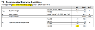

What is the the Minimum Junction Temperature of this part number SE555D ?

Hi Jay,
The data sheet lists the ambient temperature range down to -55 C.
Since the power consumption of this device is low under nominal conditions/configurations, it is assumed that the ambient temperature is the same as the junction temperature, so, it is safe to use -55C as the minimum junction temperature for the SE version.
