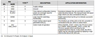

Q. They want to insert a resistor between EN/ONE_SHOT terminal (No. 6) and GND as a pull down resistor
      like the circuit in the following blog.
      https://www.instructables.com/Solar-and-Battery-Powered-Timed-Shed-LED-Light/
      They have already confirmed that TPL5111 worked correctly when the resistor range was 0ohm ~ 820kohm.
      Is it no problem to insert the pull down resistor?

    Q. I found TPL5111 datasheet said that the EN/ONE_SHOT pin must be hard wired to GND or VDD according to the required mode of operation.
    I think hard wire means direct connection. Is my understanding correct?
    Is it no problem to use a pull up or pull down resistor for setting EN/ONE_SHOT to H or L level?
    Thank you again and best regards,
    Kazuya.
  • Hi Nakai-san,
    Hard wired means either pull-up or pull-down, but not floating.
    EN/ONE_SHOT is an input pin, it won't draw current, we can pull it up or down directly or via a resistor.

    I have a question about EN/ONE_SHOT terminal.
    The customer checked EN/ONE_SHOT voltage when the terminal was pulled up to VDD with 10kohm resistor.
    The terminal voltage changed VDD to GND side when the interval time set by a external resistor was lapsed.
    So we thought that EN/ONE_SHOT terminal sank a few current and the terminal was I/O terminal.
    Q1. Is EN/ONE_SHOT terminal input only? Is it not Input/output terminal?
    Q2. Can EN/ONE_SHOT terminal be pulled up to VCC with 10kohm resistor? Is it no problem?

  • Hello Nakai-san,
    Q1) Datasheet shows EN/ONE_SHOT as an input pin:
    HIGH = EN (enable) timer functionality.
    LOW = ONE_SHOT functionality.
    Q2) Datasheet shows VIH/VIL for "DONE" pin.  I expect these levels are same/similar to EN/ONE_SHOT but cannot confirm.  Also, it does not list the max input leakage current which would define the maximum allowed resistance to still meet VIL. (or VIH).
    • Given that you tested with 820 kohm pull-down, this suggest any voltage drop caused by some leakage current is still <= VIL requirement.
      • So it *probably* would work...
    • As for pull-high with 10 kohm, it would *probably* also work and keep VIH level > 0.7 * VDD.  But again, I don't see any leakage data and...
    As you point out, the datasheet guideline and schematics use a direct connect by it's schematic.
    • So why wouldn't the customer simply use as datasheet describes?
    • I can understand, if they would like to have a pad for debug, or to isolate the pin... if so, then a 0 ohm resistor can be used.  (However, according to datasheet, this pin should never be left floating).
    • Not knowing any details - my concern (especially when pulling high) is that perhaps there is some decision the device makes to switch modes.  If you have a resistor to Vcc, then perhaps the voltage doesn't arrive at the right level internally to make the proper decision.  I don't know.
    My recommendation is to follow the datasheet and eval board design which is to tie direct to Vcc or GND.  Again, if you want the option to switch between GND or VCC on PIN6 (EN/ONE_SHOT) use a 0 ohm resistor to switch.  (Or a switch as done in the EVM.  Note they did not use a jumper on EVM which could have been removed and left this pin floating.

  • Hello Nakai-san,
    The customer should tie EN/ONE_SHOT high or low based on the functionality they want.  From the pin function table:
    When EN/ONE_SHOT = HIGH, the TPL5111 works as a TIMER.
    When EN/ONE_SHOT = LOW, the TPL5111 asserts DRVn one time for the programmed time interval. In this mode, the DRVn signal may be manually asserted by applying a logic HIGH to the DELAY/M_DRV pin.
    In either case, simply use a 0 ohm resistor to make the switch between HIGH or LOW.  This will match the EVM which is using a switch to connect the pin to HIGH (Vcc) or LOW (GND).
