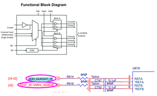

Dear Team,
May I know whether you there have single end clock level shifter
- from 1.8V to 3.3V
- 1 or 2 single end clock
Many Thanks,
Jimmy

LMK00105 has only one CLKin input and other is OSCin (crystal mode). These are selectable using SEL pin and any one can be selected.
For single ended AC coupled input at CLKin pin, it should follow the below circuit.

Hi Jimmy,
There is no single device for 2:2 level translation. If any single input out of two needs to be level translated, they can look for LMK00304 also. Otherwise they need to look for 2 device approach for 2:2 solution.
