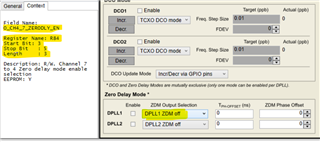

    Q2. It appears that the guide has not been updated to include the ZDM controls. DPLL2_ZDM_EN can be set on 262h bit 0 as you have stated, but 0x1D1 is not a register used for ZDM. Register 0x1D1 are DPLL loop filter settings that are reserved and should not be adjusted.
    Q3. To enabled ZDM for DPLL1, set R594[0] (DPLL1_ZDM_EN) high. To enabled ZDM for DPLL2, set R610[0] (DPLL2_ZDM_EN) high. R84[5:3] selects the output that will be ZDM for DPLL1. R84[2:0] selects the output that will be ZDM for DPLL2.

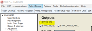

    Please note that if you hover (put your mouse over a control), you will be able to see the registers associated with that control on the left side of TICS Pro as I have shown below:
    Here is also a TICS Pro configuration I created in our lab:
    ZDM_LMK05028.tcs

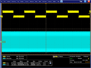

    Please load this file and then toggle (set high, then set low) the SYNC_SW as shown:
    Once you have toggled the SYNC_SW, your input and output should be synced as shown below:
