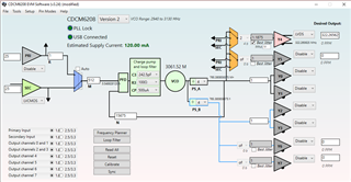

I'd like to generate such ref. clock with a CDCM6208 V2, but I can't find any clear indication on how to calculate the jitter / phase noise when using the output fractional dividers.
I see that I can't obtain the required frequency with an integer divider.
My Idea was to adopt the following configuration to obtain the desired clock. I see that the EVM software can plot the phase noise for integer divider outputs but not for fractional dividers ones.

    While using CDCM6208 for required fractional output frequencies, its PFD frequency go very low and it will affect the jitter performance of the device.
    Instead to this I would be suggesting to have a look on the CDCE6214, which would have fractional PLL and can generate required frequencies with higher phase detector frequency. It has an option for 1.8V supply option also.

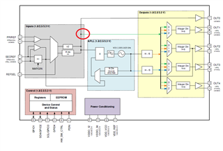

    I also need a 100 MHz clock output, which I thought to derive directly from the REFCLK after the x2 input multiplier (the green path in the following graph), using a 50MHz reference clock:
    The problem is that in TICS pro the connection is different. The MUX before the integer divider is not connected to the clock AFTER the x2 multiplier, but BEFORE. So I can't output 100MHz, but 50MHz, as the reference clock.
    Can you confirm that the datasheet is wrong and that I should follow the TICS configuration?
    Thank you
    OUT0-4 can have an REF_CLK and PFD_CLK output options, where block diagram in datasheet shows generic diagram for reference output.
    Table 9 in datasheet shows the register settings for REF_CLK or PFD_CLK at output channels.
    R25[9] selects the MUX for REF_CLK or PFD_CLK out.
    Thanks!
    Ajeet Pal
    There would be one update on the PFD_CLK out, as ref multiplier operates in delay based circuit, it won't generate 50% duty cycle PFD clock. So your generated 100MHz out from PFD_CLK won't have 50% duty cycle output.
