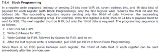

  • Hi David,
    if you write one register at a time, CSB has to be toggled once per register, we cannot keep CSB LOW all the time.
    I believe LMX2820 also support block programming, please try (I didn't verify this before). Below is the description from other device.
