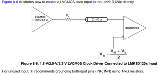

I am going to use a 3.3V CMOS single-ended input as clock input for LMK1D1204.

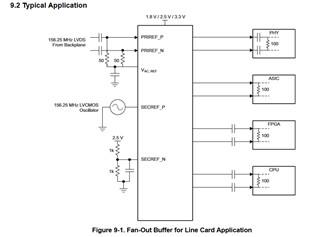

How should I configure the input circuit? I've found a similar reference design for the 3.3V CMOS single-ended clock input.
Can I use the recommended application setting for single-ended input signals?
