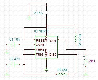

Dear all,
Kindly, attached is a basic NE555N astable multi-vibrator where the required times are:
OUTPUT HIGH: 2 sec.
OUTPUT LOW: 20 sec.
The problem is that I am receiving a message "operating point not found", and the other problem is that i need a switch SPDT within TINA-TI to be controlled by this timer. My TINA-TI version is Version 7.0.80.96 SF-TI.
Please help me with this problem.
Yours truly,
Mahir

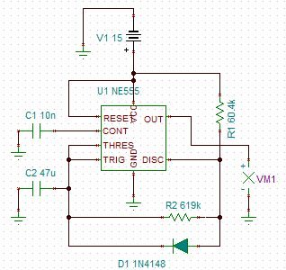

  • Hello Mahir,
    Your circuit as drawn will have a longer output high time than it will be low. This is opposite of your requirement.
    To correct this, I suggest. changing R1 to 60.4k and R2 to 619k then add a diode across R2 (cathode to C2 side).
    Now C2 will charge through R1 and new diode in 2 seconds while output is high and C2 will discharge  through R2 in 20 seconds while output is low.
    I do not have a answer about the Tina simulation, but changing the default settings for higher accuracy or longer settling time may help.
    Ron Michallick

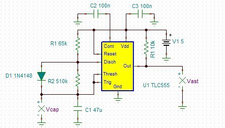

  • Dear Mr. Ron,
    Thank you for your response...
    I made the changes on my cct as attached, but also the same problem "operating point not found", I reached the required cct using TLC555 but still wondering about the message appear with NE555.

  • Mahir,
    Send me your NE555 TI-Tina circuit.
    I will try to get it to simulate properly.
    Ron

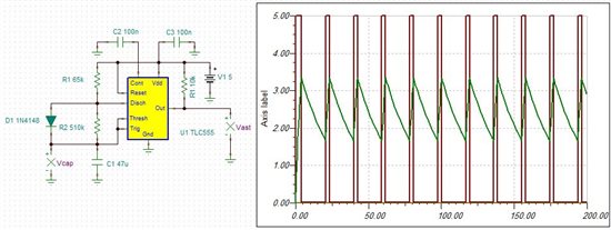

  • Dear Ron,
    I am not sure why I can't upload the simulation file (.TSH) to the site!!! please help me with this.
    I solved this case with Mr. Marcos opinion (using voltage generator with general wave and by changing the peak values and the times) and this worked with the voltage-controlled switch, but using NE555 is important for further hardware implementation.
    Also, the use of TLC555 as attached, gives the same signal, but not working with the voltage-controlled switch, and this is not obvious for me!!!!

  • Mahir,
    I ran into the same problem. I solved it by using a different tool.
    Try: Analysis - Steady State Solver - MaxSearchTime = 60
    This is my only solution.
