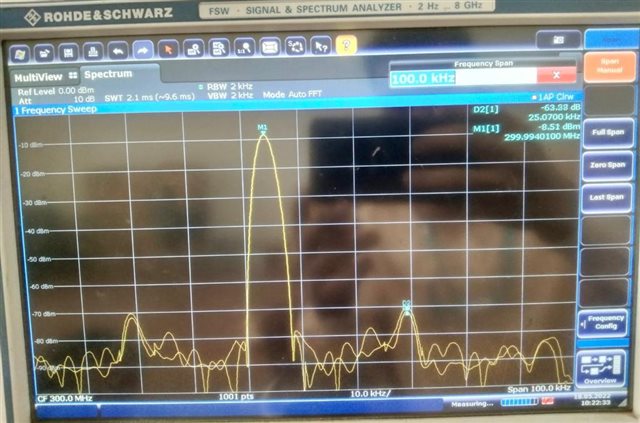

we are using LMK04828 chip on our custom board and generating 256MHz clock and 4MHz SYSREF,we are seeing 25KHz spur on the dac output.
i would like to present my prob in two cases
CASE1 :
we have an eval board which is using LMK chip and DAC with CLKIN0 =10MHz and external VCxO as 160MHz,generating 256MHz clock and
4MHz SYSREF. we are generating DAC output from the board which is very clean and without any spurs. i hav attached the configuration file of it.
CASE2 :

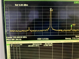

on our custom board with LMK04828 chip and generating 256MHz clock and 4MHz SYSREF,we found two spurs at 25KHz apart from centre
we feel it is generated from the combination of both VCO(2560MH

z) and External VCXo(100MHz) used in the design because
1. we changed the VCO to 3072 we are not seeing the spur at 25KHz but since the VCO frequency which was selected is at the border of VCO range,we are getting other freq spurs and noise floor also getting increased.
2. we tried to change the external VCxo of 100MHz to 160MHz but in single loop PLL2 mode we still find the 25Khz spurious.
i have attached the configuration file for VCO of 2560MHz and VCO of 3072MHz.
is there any way to reduce the level of these spurs?

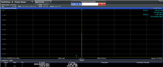

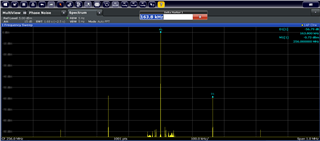

    I believe the captured data are not for 256MHz output frequency (300MHz) and it may have different configuration file and showing 25kHz offset spurs.
    From the provided config file for 100MHz VCXO and 256MHz output, you are involving PLL2_R divider to reduce the phase detector frequency for required VCO frequency, which is responsible to generate the spurs.
    To avoid these spurs, change the VCXO (external frequency) to 160MHz and remove/reduced the PLL2_R divider and see the performance.
    I am not sure, if you have reduced/removed the PLL2_R divider and still getting the spurs at 25kHz.
    Thanks!

  • Hi Ajeet,
    Thanks for early reply ,
    1.The output frequency was 300MHz , i was mentioning about the clock used from the LMK are 256Mhz and 4Mhz as  sysref.
    2.My configuration for external VCXo of 160Mhz is same as above attached EVal board configuration file, the only change is i hav changed the external
       OSCin to independent and turned off PLL1 .i am attaching my configuration for VCXo of 160Mhz for reference.
    3.i dint understood how can we remove PLL2_R divider .in my case it is 1 for 160Mhz oscin

  • Hi
    hope you resolve my issues,
    i was trying to debug the issue of this spur. i hav probed the DCLOCK  out of the LMK04828 and i found out that the spur was coming from the LMK it self.
    Even i hav tryed to change the VCo freq to 3000Mhz and still i could find the spur
    attached are the screenshoot .
    Below are the captures of 256MHz output from LMK04828 with your above used config file with 160MHz VCXO.
    There are no spurs at 25kHz offset.
    From your results, I would be having few observations:
    1. Why the fundamental (256MHz) have less output power (< -10dBm)? There can be some setup issue. check the RF cable, etc..
    2. 25kHz is consistence. It may be from source. Can you replace the 160MHz/100MHz source and see the performance.
    Thanks!
    Ajeet Pal
  • Hi Ajit
    I am working along with Manish
    Could you provide us with the captures for 256MHz CLK OUT using 100MHZ Eternal VCXO, 10MHZ Reference clock ?
    Thanks & Regards
    TI doesn't have the LMK04828EVM with 100MHz VCXO on board, hence I could provide the test data with external input from Sig gen at OSCin input and operate in single PLL mode.
    As mentioned above, while introducing PLL2_R divider in path, it added the spur and to remove the spur, change the input (VCXO) to 160MHz.
    With 100MHz VCXO/external input and having 256MHz output, you need to be incorporate the PLL2_R divider, which added spur, shown below.
    Thanks!
    Ajeet Pal
  • Hi Ajeet
    I have few queries
    1. In the spur free image which you have sent for  256MHz with 160VCXO , which configuration of LMK are you using. single loop or dual loop??
    2.In the above image 256MHz with 100VCXO , the spurs is at 163KHz, how it is related to any of the clock which are generated and used in our config file?
    3. we have already tried with VCO of 2500MHz [PLL2 R Divider is 1] and found the spur at 60KHz
    Attached are the configuration file and the clock output
    We need to know the reason for the spur and also the relation of this spur frequency wrt any of the LMK clocks or VCXO or VCO
  • Hi Shekhar,
    1. The measurement with 160MHz reference external from sig gen and used in single PLL (PLL2 mode) only.
    2. I'll get back to you on this.
    3. As mentioned above, if you go with PLL2_R divider value 1, there is no spurs. I'll check this configuration in my setup and will update you.
    Thanks!
    Ajeet Pal
  • Hi Shekhar,
    As already mentioned over email, the spurs at 163.8kHz in LMK04828EVM generated through on board unused 122.88MHz VCXO. After powering down the VCXO, the spurs goes down and sees very clean output.
    OSCin – 100MHz, PFD – 40MHz, VCO – 2560M; Fout – 256MHz
    Thanks!
    Ajeet Pal
