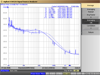

    I checked this out in the lab, with the default TICS Pro configuration, I've got the following plots.
    The memory trace (light blue) is the phase noise at room temperature, full assist mode with calibration data at room temperature as well.
    The active trace (dark blue) is measured at -40C. We can see that the loop bandwidth is smaller and therefore close in phase noise higher. This is due to Kvco being smaller at cold temperature. This is a normal behavior of the VCO.
    Then I change the charge pump to 3mA. Loop bandwidth gets smaller but the overall phase noise is normal.
    In your design, what is the loop bandwidth and phase margin?
    If the phase margin is already small (e.g. <40 degree), because Kvco is smaller at cold, then the phase margin will further decrease at cold temperature. If phase margin becomes too small, the PLL may not be stable.

  • Hey Noel, thanks for running that experiment for me and providing those plots
    I believe our phase margin is around 47-50, we are running a 200MHz Fpd w/ 3mA charge pump (expanded to 6mA to increase loop bandwidth improved results but we would prefer to keep 3mA)
    Our concern however is settling time, since calibrating at -40C causes it to lock at all temp. However, settling time is worse at -40C than it is at +25C and +71C - a lock time at +25C of around 8µs would be 11µs or so at -40C. Additionally, the waveform on the SSA appears to be underdamped somehow, not quite sure why it appears like that or why the performance is much worse. This is jumping from the middle of VCO cores as well, it's not like we are on the edge of one or anything like that

  • Hi Dylan,
    Here is the Kvco vs temperature at VCO4.
    Frequency Kvco at room Kvco at -40C
    10.8GHz 120MHz/V 38MHz/V
    11.3GHz 141MHz/V 44MHz/V
    11.8GHz 168MHz/V 81MHz/V
  • Thank you for running those tests, I think we will try and resolve this issue by increasing the charge pump to 12mA from 3mA when running at cold
  • Hi Dylan,
    This is a good idea.
  • A follow up question to this approach: would changing the value of charge pump used during the auto calibration have any effect on the values the PLL self calibrates to? We are currently using a 3mA pump current, but I wonder if using a 15 or 12mA value instead would improve the performance during Full Assist
  • Hi Dylan,
    VCO calibration is performed in an open-looped configuration, so the charge pump current does not play any role in calibration.
