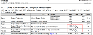

Hi Team
Customer plan to use DC coupled output mode. In EC table, is the VDD_Yx_Yy -0.76  typical value?  and if they choose VDD_Yx_Yy=3.3, so Vcm_DC=2.54V?
Thanks!
    the output stages of CDCM6208 are CML drivers. This is a VDD referenced output type. For LVDS (Low-power CML) the output swing is adjusted. If you do DC coupling the VCM will be VDD_Yx_Yy - 0.13V. At 3.3V this results in VCM_DC = 3.17V typ.
    It is recommended to do AC coupling with CDCM6208.

  • Hi Julian,
          Our project used CDCM6208 and 3 outputs of CDCM6208 are configured as lvds output.The VDD_Yx_Yy  is 3V3.I measured the three lvds output whose VCM_DC are around 1.0v ,not 3.17V.And 1.0V VCM meets the LVDS standards.So Is there anything misunderstanding about the VDD_Yx_Yy-0.13 in
    CDCM6208 datasheet?
    Thanks!
    have you measured the common mode at the receiving device after the AC coupling cap?
    If measured DC coupled, was the receiving device connected? If yes, what is the input structure? Does it has an internal biasing circuit?
    Julian
  • Hi Julian
        I misunderstood the Vcm_DC and VCM_AC.3 lvds outputs are ac coupled,and one of them connects no received device.The VDD_Yx_Yy is 1v8.And I measured the cdcm6208 side ,the VCM is about 1v0.,Sorry about providing the wrong message.
    ok with VDD_Yx_Yy = 1.8V and AC coupling the common mode at the CDCM6208 side is around 1V (VDD_Yx_Yy - 0.76V typically).
    With AC coupling that does not matter however. You will need to ensure that the receiver has a biasing circuit internal or external.
