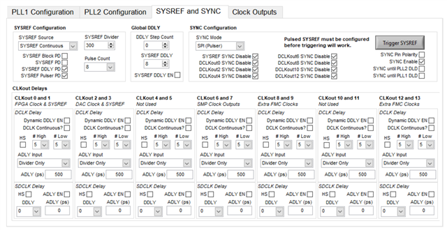

  • Hi Brooke,
    The SYSREF block is configurable to generate continuous clock or pulses. As shown in the previous diagram, we are simply using the divider of the SYSREF block to divide down the VCO clock. The output from SDCLKout1 is a continuous 10Mhz clock.
    SYSREF divider has the same performance as the Clock divider, their additive jitter is pretty much the same.
    It is recommended to use TICS Pro to setup the desired configuration in order to get the correct register setting. Setup the correct register setting by reading the datasheet is difficult.

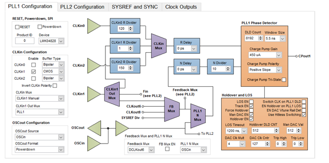

    On my hand, there is one ADC34J25 demo board with LMK04828. Here I want to use external reference clock(coming from keysight N9010A 10MHz out) for locking both PLL1 and PLL2. Here I want to use dual-loop mode for the LMK04828. This demo board has one 100MHz VCXO for the PLL1.
    Please see my configuration for the PLL1, PLL2, SYSREF/SYNC and CLK output below:
    From the demo board, I can see the LED D4 is green while LED D1, D2 and D3 are not open.
    From my viewpoint, I think the LMK04828 is not locked now.
    Could you please help me to check the configuration above about the LMK04828? Thanks for your time.

  • Hi Brooke,
    Can it possible to share the configuration file used for LMK04828 programming to have a look on register write details?
    From the config images, STATUS_LD1 (D3) should ON for PLL1 lock and it seems it is not locking the PLL1.

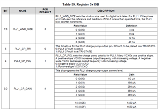

    I think I find the root cause.
    In my configuration, I only changed the register 0x15B from 0x14 to 0xD4, and hen the STATUS_LD1 (D3) is on with green color.
    Could you please let me confirm this is the status for the LMK being locked now?
    Please see this register 0x15B. What's the reason from the value from 0x14 to 0xD4, the LMK can locked? It's better you can give me more explaination.
    With many thanks.
  • Hi Brooke,
    PLL1_WND_SIZE is set for the digital lock detect for PLL1. The window size set based on phase error between reference and feedback of PLL1. If there is more phase error between them, window size need to be increase. and STATUS_LD1 will show the lock detect for PLL1. PLL1_WND_SIZE POR default is 0x3 and keep the same, lower window size can go for higher PFD frequency.
    Yes, if STATUS_LD1 (D3) is ON, it indicates the PLL1 locked for the given settings.

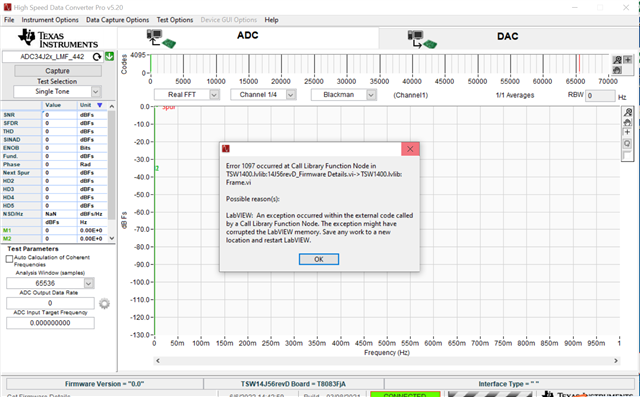

    Here I got one EVM- TSW14J56, which I used for connecting the other EVM-ADC34J25. When I connected these two EVMs with FMC connectors, I open the GUI for capture the data, but here I got one isse as below on the HSDC Pro.
    Could you please let me know what's the issue behind? Should I need to use other connectors between these two EVMs?
    With many thanks.

  • Thanks Pal. I have fix the issue. Because of my current limitation on the power supply.
    Thanks again.
