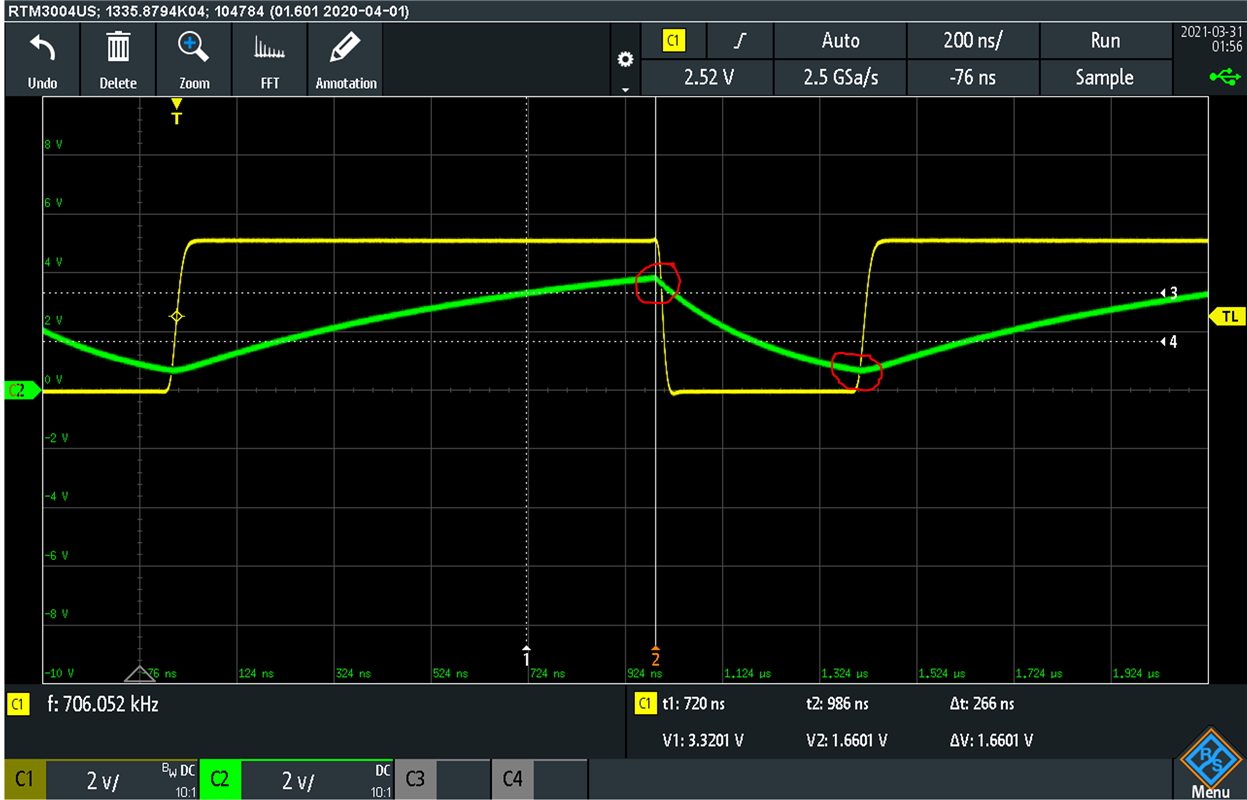

  • Hello Yohei,
    Yes, it would be helpful to see measured values of both devices in order to see if the trigger and threshold values are different. This can be done by measuring both the timing capacitor and the output waveforms together on the same plot. Specifically we would want to see
    1. An oscilloscope capture of the SE555M timing cap and output with cursors measuring the voltage level at the top and bottom of the timing capacitor waveform.
    2. Same as #1 for the SE555SP
    An example is shown below. The cursors for the measurement should be placed on the peak and bottom the timing capacitor waveform for both measurement 1 and 2. I have highlighted these points of interest in red below. This will highlight the level of of both trigger and threshold voltage trip points for each device and we can see the difference between the devices.
    Chris Featherstone

  • Hello Chris,
    Please allow me to attach two files received from customer for the scope shots of both MIL and Space parts.
    Hope it helps.
    Also, we were informed from customer that we need to resolve all the questions (including question 1 and 2) by 6/20 since the customer is to report to  JAXA.
    1. Will this device sealed under atmospheric pressure or under reduced pressure?
        (RGA is tested as if the device is sealed under atmospheric pressure)
    1. Are there any reports of anomaly or malfunction for this date code (1935A)
    Sorry for the push but we really do need your kind support to conclude the case till then.
    JM38510/10901BPA
    Power Supply voltage 4.903V
    Pin6 MaxV 3.34V
    Pin6 MinV 1.53V
    5962-9855501VPA
    Power Supply voltage 4.994V
    Pin6 MaxV 3.41V
    Pin6 MinV 1.59V
    Resistance at R4 is confirmed 221Ω with multimeter.
    Thank you for your kind support.
    Kind Regards,
    Yohei
  • Yohei,
    Looking at the supply voltage difference it looks like these measurements were on two different boards? Either way there is a 2.07% difference for the threshold values and another 3.85% difference for the trigger values. This part to part variation combined with component error would explain the difference that is seen.
    Chris Featherstone

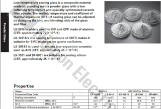

    The low Tg glass sealing temperature in SE555-SP is not specified in our database. We have to go to the manufacturing to request the information, which it will take some time to obtain the information.
    The sealing temperature for CDIP should be anywhere between 350C to 435C range as shown in Nippon Low Tg Glass datasheet. There are other companies such as Schott and YEK Glass companies etc.. The working temperature of the sealant materials are generally above 300C (from what I see for the CDIP hermetic sealing application).
    Even we assume the sealing temperature is 300C, the vapor correction factor is calculated to be at approx. 0.452vol% < 0.5vol% (you may back calculate the sealing temperature and you will realize that the SE555-SP's corrected RGA figures meet MIL-STD-883 TM 1018 criteria).
    I will post the actual sealing temperature data once we are able to obtain the information from the manufacturing.
    Raymond
