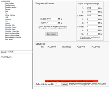

    Apologies on the delay as I had to tackle a few other matters. I think what you are saying is making sense, but I am struggling to use the TI tool (TICS Pro) to assist with connecting the dots between your comment and our design. I was playing with the parameters of the PLLs, but I am still getting lost. At this point, I was going to use the frequency planner, but it is not mentioning there are any solutions to my inputs. Would you be able to help inform what I am doing incorrectly? My current plan is to have two LMK04610 devices. One cascading the other. The first is what I am trying to set up now and will act as a buffer for the input frequency and will have the jitter cleaning functionality if possible. I was selecting 0 for the VCXO frequency to see what it would provide.
    Thanks again,
    Ryan

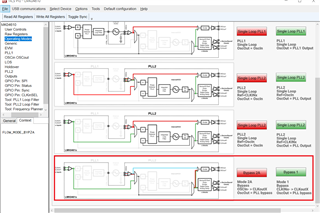

  • Hi Ryan,
    If you want to have your first LMK04610 in bypass/buffer mode, you can't be having jitter cleaner functionality.
    For buffer mode, you can follow the Bypass 1 Mode, which can provide the CLKinX input to CLKout output.
    For having jitter cleaner option, you need to operate in dual PLL mode and VCXO frequency should be based on selected internal VCO frequency.
    Thanks!
    Ajeet Pal
