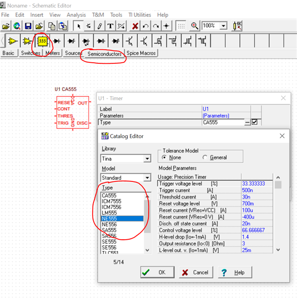

    We wouldn't be able to provide that level of detail on our designs, however there is a model built within Tina Ti. In the below image you can see under the Semiconductor section that there is a 555 timer. You can double click on it to change the type to the NE555. The TLC555 is the only component level model we currently have. Tina Ti is a free download we provide in the following location:
    https://www.ti.com/tool/TINA-TI
    If you have questions on how to use Tina I can assist you.

    We have checked the TI-TINA software too but again it doesn't give us the transistor level information and parameters for modelling. We require this information because we need to know the current values within the NE555 timer circuit at each transistor and resistors.
    But as you mentioned its not possible for TI to share these information with us, so is it possible for you to verify whether the attached SPICE model for the LM555 is correct i.e. can we use it to simulate and compare the results with real LM555 timer? It was provided as an example with the Ngspice software.

    Extracting all of the information for verification would be very difficult. We don't have active designers on this product since it was released almost 50 years ago. We have moved on from component level simulations and our simulations are macro behavioral models that run much faster and have far less convergence issues. We are unable to verify or support a model that is developed outside of the company. Sorry for the inconvenience.
