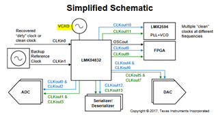

My customer wants to use the LMK04832 by replacing VCXO with TCXO in application below.
Are there any problems with applying TCXO?
Thank you.
JH
  • Hi JH,
    If customer wants to use single PLL mode (PLL2 only), they can go ahead with the TCXO and can get the fixed reference frequency at OSCin inputs. Whereas dual PLL mode need VCXO only, which would lock the frequency based on CPout1 from PLL1.
