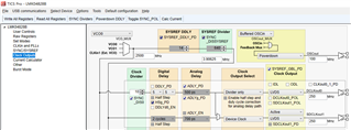

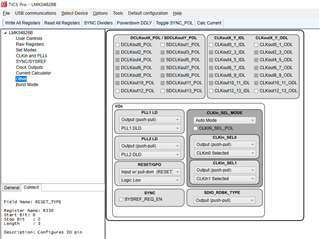

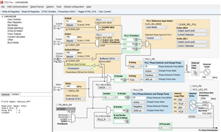

    The customer has feedbacked that he has resolved the problem mentioned earlier, it is the problem with his test equipment. However, a new issue has been encountered. The auto mode in CLKin_SEL_MODE of LMK04828 PLL1 cannot be used.  When the clkin0 signal source is disconnected, the chip does not automatically switch to CLKin1 to start working. The following screenshots are his configurations:

    To enable the input clocks in auto mode, CLKin_SEL_MODE set to --> 4 and LOS_EN --> 1.
    In the attached file, LOS_EN is 0 and seems, auto mode is not enabled.
    Please follow the section 9.3.5.3 in datasheet, which shows the sequence for clock selection in auto mode.
    Thanks!
    Ajeet Pal

  • Hi Amy,
    Sorry for the delay.
    While doing the auto select CLKinx, device is not entering the holdover mode. Hence, seeing an unlock while changing the CLKinx or OFF the first CLKin.
    To entering into the holdover mode, enable the HOLDOVER_PLL1_DET [1], which enters into the holdover mode, when PLL1 gets unlock.
    Updated config file attached here FYR.
