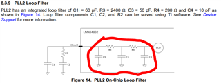

There are R364, R365 and R366 registers in TICS Pro, however in its datasheet, table 5 shows only R364 and 8.6.2.8 shows information of only R366.
Could you clarify what these registers are?

    R364 and R365 registers have the fixed settings for PLL2 loop filter internal components values and remaining loop filter components would be added based on loop filter settings (PLLatinum sim tool).
    R366 register field self explanatory from table 77.
    TICS Pro shows R364 and R365 values are both 0.
    Do you mean filter setting made by PLLatinum sim tool may change R364 and R365 setting value?
  • Hi Sato-san,
    The default settings of the R364 and R365 in TICS Pro defines the fixed internal loop filter component values.
    Pllatinum sim tool optimized the external loop filter component values only.
    Thanks!
    Ajeet Pal
  • Hello Ajeet-san,
    Thank you for further explanation. Since TICS Pro has 0 values on R364 and R365, this 0 setting of the registers set internal loop filter to C1i=60pF, R3=2400 ohm, C3=50pF, R4=200 ohm and C4=10pF, correct?
    So we should write 0 to the registers and shouldn't modify them from 0, correct?
  • Hi Sato-san,
    Yes, that's correct. These registers should be default write values to 0.
