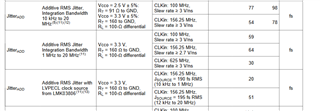

LMK00304 only has the Additive RMS Jitter parameter of 1MHz to 20MHz in HCSL output mode, is there any Additive RMS Jitter parameter of 12KHz to 20MHz (or 10KHz to 20MHz)?
the datasheet has 3 lines of additive jitter specification. Please see the first line:
Julian
The table that Julian posted is actually for LVPECL output mode. For HCSL with an integration bandwidth of 12KHz to 20 MHz, additive jitter is typically 48 fs.
Connor
