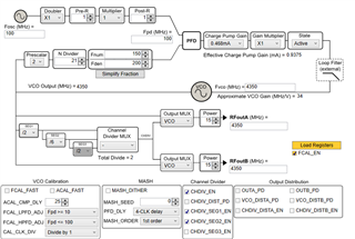

LMX2582: Device Configured for Frequency from 4360MHz to 5000MHz with Maximum Output power from PLL
Part Number: LMX2582
Hi team TI,
We Required Configuration from LMX2582  IC
Output Frequency : 4360-5000MHzz with +8dBm Output
Input Frequency to Osc In : 100MHz with +6dBm
Fpd= 100MHz
Output Frequency Selection : VCO for Both A & B Channels
Pre-scaler : 2 ; N Divider = 21 , Fden= 200 , Fnum= 150 to 800 (Variable)
As Per FVCO = FPD*Pre scaler (N Div+(Fnum/Fdenum) we should get output frequney
but we are getting Output from 4360 to 4400MHz where Fnum = F denum (Upto Fnum=200) only
Is it Right ??
Can you give any suggestion
PFA for your reference
