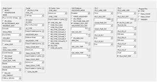

HI,
I use the LMK04803 to generate clocks.
Mode: Single PLL, Internal VCO, 0-Delay
Input clock: 40Mhz;
Output clock:80MHz(11 channels)。
The parameter "PLL2_N_CAL" is different:
TICS PRO:
Code loader:

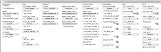

HI,
Input clock: 40Mhz;
TICS PRO:
Code loader:
During the VCO calibration in feedback path mode, PLL2_N_CAL doesn't affect or may be can keep same as PLL2_N value. Hence, while doing 0-delay mode, both values seems differ but can be set PLL2_N_CAl value same as PLL2_N settings.
Thanks!
