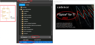

I couldn't see TLC555 in the library of PSPICE FOR TI
So, what ti devices are covered in this free software

TLC555 model in PSPICE FOR TI may be found in the search path of the tool, see the left image below.
The PSpice model can be found in the link below.
https://www.ti.com/product/TLC555#design-development

The image below is PSpice for TI, 2022 downloaded recently. The previous captured image is my other laptop, which is loaded with 2021 version from TI.com. I think that you may need to update your tool's library.
https://www.ti.com/tool/PSPICE-FOR-TI
There is only one version of PSpice-For-TI.
