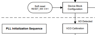

Hi team,
LMK05028 output configuration have to change as below sequence if I understand correctly.
1. Write 3fh to R51 : all output disable
2. Write to corresponding registers based on the updated configurations
3. Write 1b to R677[1] : PLL2 soft reset
4. Write 1b to R677[0]
5. Write 1b to R51[1-0] : output  enable
Can customer add soft reset before the above sequence?
0. Write 1b to R12[7] : soft reset
4. Write 0b to R677[1]: PLL2 soft reset disable
4'. Write 0b to R12[7] : soft reset disable
I think it is aligned with the datasheet fig.64

  • Hello Hayashi,
    I would recommend the following. The soft reset should be preformed after the outputs have been enabled.
    4. Write 1b to R677[0]: PLL1 soft reset
    6. Write 1b to R12[7] : soft reset
    7. Write 0b to R12[7] : soft reset disable
    The soft reset should be performed after all of the device settings have been reconfigured and the output have been enabled.

  • Hello Toshiaki-san,
    1. No, there is no issue using the sequence Hayashi-san has described.
    2. Sequence S1 and S2 will work as well.
    A soft reset can be performed at anytime in the output configuration change, but we recommend performing it at the end of the sequence as I described above.
    Kia Rahbar
