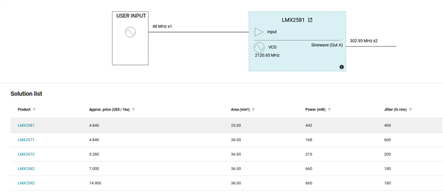

Hi Jiawei,
Is a LVCMOS input a must or as is any single ended input fine? Current consumption will be too high above 250Mhz. Duty cycle and amplitude will both suffer. Potential for EMI problems as well.
Here are some alternatives.
