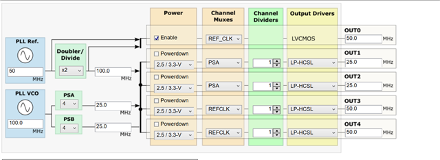

I was looking at the CDCE6214 to act as a zero delay buffer, but I do not see how to configure the registers to allow that.
Using the TICS Pro tool, I could not work out how to set up the PLL so that the outputs would be the same frequency as the inputs with SECREF as the feedback.
The closest I could get is the incoming frequency divided by two.
Obviously I am missing something as you would need the same frequency to even use the external feedback.
Thank You,
