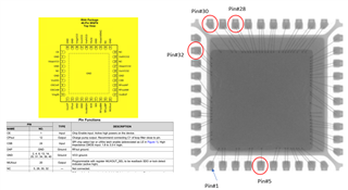

i have a question on the X-ray regards for item LMX2592RHAT. based on the datasheet, al pins are connected in the Xray but pin configuration in datasheet states that some pins are NC.
can you help to check on the attached x-ray whether it is correct?
thanks
  • Hi Josie,
    The name NC may be misleading, but it is a common nomenclature to name a pin that has no use. It is also very common that a NC pin has bonding wire to the chip.
    For this device, the NC pins can be left floating or shunt to GND.
