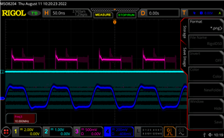

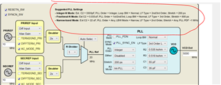

We are using the LMK03318 in our design and have started to have issues with long term reliability of the PLL lock. I've attached our
settings and we are testing this on the LMK03318EVM evaluation board, with a 10 MHz input reference.

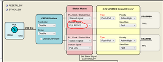

OUT7 is configured as a 10MHz clock and I am comparing to the input reference on an oscilloscope, and initially the output
and input appeared well locked. When I enable the interrupt enable on register R17, at first there are no sticky status registers
flagged. However after leaving for several hours, the LOL_INTR and CAL_INTR flags are set and there appears to be some phase shift
between the input 10 MHz and OUT7, as seen in the below oscilloscope trace (Pink/CH3 is OUT7 from LMK, Blue/CH4 is 10MHz input reference).
We believe we have configured everything per the datasheet and EVM software requirements, but it seems like something is not well optimised. Any help is appreciated.
