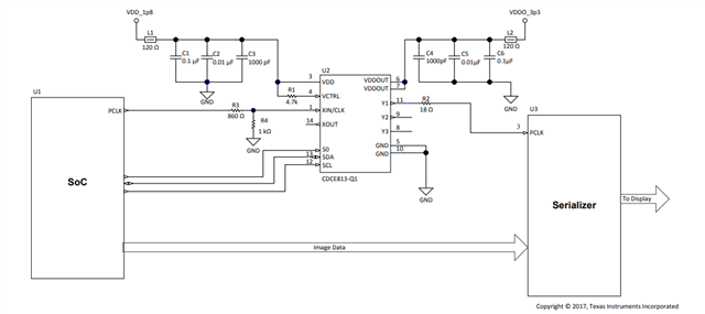

Hi team,

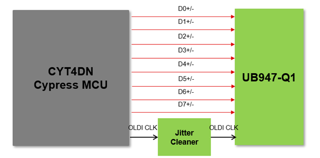

My customer are looking for one clock jitter cleaner to use in below application.
  • The 947 jitter requirement is 0.2UI, which 1UI is equal to 1/(7*fClk)
  • The PCLK of oLDI is 2056*741@60Hz, so the clk frequency is around 45.7MHz.
Could you kindly give a recommendation part for above application? Customer want to a cheap part. Thanks!
