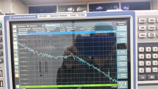

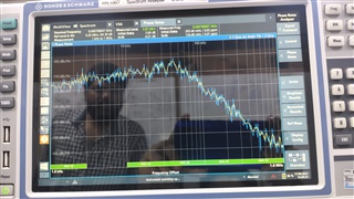

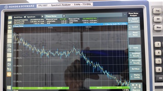

Below attached Phase noise for reference.
Phase noise of VCXO 100MHz (Y10)
Phase noise of LMK Output (DCLKOUT6)- 256MHz

    I do see that the register programming has FB_MUX_EN=1, which is driving the 4 MHz continuous SYSREF to the NCLK muxes - this may be introducing some noise in the feedback path, but I'd be surprised if this was the primary source of the noise.
    It's notable that the shape of the phase noise on the TCXO and the shape of the phase noise on the LMK are so similar. The 10 MHz TCXO phase noise looks astonishingly high, around 30 dB higher than what I would expect based on the part number in the schematic. The phase noise performance from the TCXO datasheet suggests you should be seeing -140 dBc/Hz at 1kHz offset; clearly your plot is well above this.
    I can think of a few possibilities:
    • TCXO is malfunctioning, and not performing to spec. The TCXO noise is so high that even the PLL1 loop filter is unable to completely suppress it, and reference noise is scaling through your whole system. This could be tested by validating a TCXO that performs according to your specs, and providing it from off-board to the other clock input.
    • You may have a switching supply or something similarly disruptive on the power supply and grounding for the TCXO or VCXO that is injecting broadband noise. This could be validated with a clean 3.3V supply if you suspect something like this is happening, but if you don't have switching noise, CMOS circuits switching in-band, or other sources that might be coupling broadband noise into your board, this might not be a likely problem.
    • The spectrum analyzer you are using may have a fundamental measurement limitation - check the datasheet for the analyzer and confirm that it can actually measure the phase noise you need to see at the frequencies you are measuring.

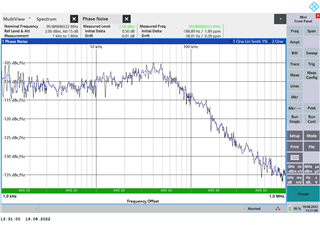

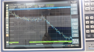

    We have tried with PLL2 mode and disabled PLL1, as well as an external VCXO of 100MHz (Part: CVSS-945-100.000).
    The phase noise are shown below, and  is still not good.
    VCXO Phase noise (CVSS-945-100.000)
    LMK Out Phase noise
    How do we remove the low frequency noise(~48KHz) on the supply?
